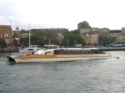

Low wash cat in service on Sydney Harbour
Garry Hartshorn is offline   Reply With Quote
