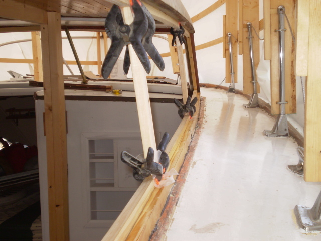

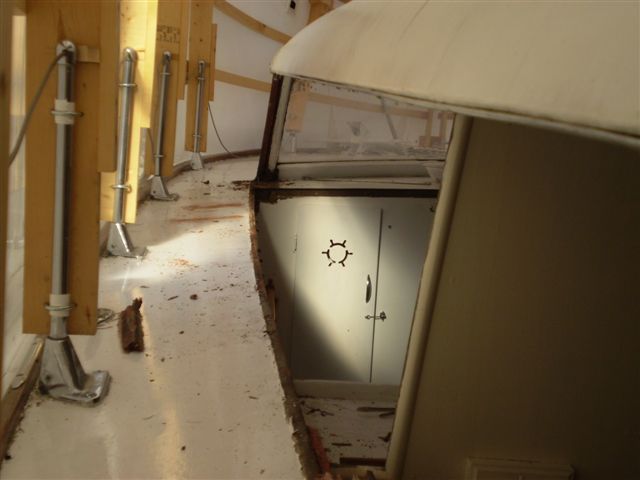

    Below are some pictures of water damage around the cabin side windows after the trim was removed.

    More pictures

    Your pix really exemplify why shortchanging on maintenance is false economy. You can see all of that silicone that somebody gooped in the windows instead of taking them out and rebedding them... But hey, it's a beautiful old boat and you're doing it the right way.

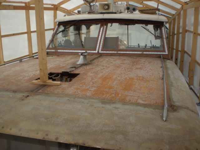

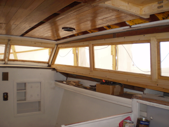

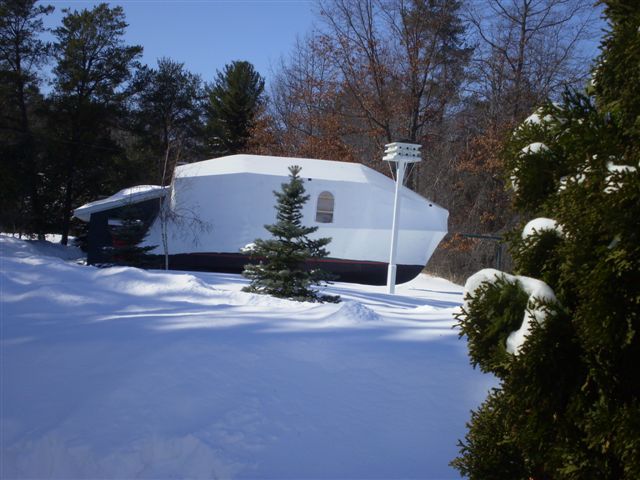

    Progress
    We moved the boat 3 miles from the marina to John Winter's workshop. We built a support frame inside the cabin to hold the cabin top up after removing the windows.
    Then we built a support frame over the boat to hold the shrink wrap away from the cabin giving us room work on the outside while keeping everything dry during the winter.
    The cabin windows on the starboard side have been removed. All of the wood on the lower sill will have to be replaced. The plastic vent cover over the galley has also been removed in preparation to remove the vinyl fabric over the cabin top and replacing it with fiberglass.
