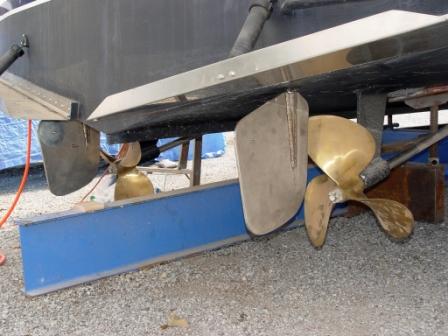

    The stainless is isolated from the hull with delrin bushing sleeves, and the bronze spud is isolated from the shaft log by a rubber hose, just like modern Al boats. The welder will be installing the logs over the next week or so. For anybody interested in doing this, Chesapeake Marine Engineering (http://www.rockholdcreekmarina.com/repair.html) did the work and they were VERY reasonable.

    New SS Rudders
    They look great, thanks for the view. I only got to see the 'new' SS rudders on our 46' one month and a half after they splashed down. Shafts and props are the only thing not 'new' below the red stripe in this picture taken a day before bottom cleaning for the trip home:

    It's great to see a sister ship for comparison. Any idea what SS material yours are made of? Also, did they isolate the stuffing box from the shaft log on yours, or just leave it in the original configuration? Last question, have you figured out how to get a grease gun on the nipple? With the old stuff we cut out, the nipple was on the backside pointing down--with all of the cabinetry in place it was totally inaccessible unless you had 5-point articulating wrists and elbows.

    "It's great to see a sister ship for comparison."
    As to the type of SS used, I have no idea. The rudders, shaft logs, stuffing boxes, and all four propeller shaft struts were completely replaced by a boat builder who manufactures 55' custom aluminum motoryachts with a cruising speed of 65 mph. Since I would be not there to witness the work, I researched the company and felt confident in their work in aluminum . They were recommended and subcontracted by the yard owner and repairman who blasted the previous owner's mastic off her bottom, applied the correct sealer, and re-coated same in addition to some major and minor cosmetic work topsides.
    I wish that I could answer all your questions accurately, however, when we pull out the dresser to re-cut the MS rug, I shall check the position of the nipples and report back.
