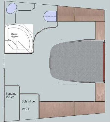

Anyway, we've pretty much wrapped up the design phase for the aft stateroom. Here's what we have in mind:
Hi
a thought on your aft cabin design. Berths, and in particular double berths, dont need to be full width at the foot. Have you considered rounding off the forward corners so as to follow the curve of the head compartment? even better, why not make the berth taper at the forward end - it doesn't change the size of the bed (or the comfort of those using it) and because you then see more floor space, it makes the whole cabin look bigger and less cramped, especially between the foot and the head door. You can go one further by having a recess at floor level, all around the bed, which makes a dramatic difference to the overall look of the cabin

Thanks, Sean.
I've been letting the Roamer lie fallow while cracking out the maintenance on my Connie. I should be able to return to the Roamer by July or so.
David, I see what you mean about the bed. But the fuel tank is rectangular and just happens to have the same perimeter dimensions as a standard queen-size mattress. Lining up the pros on one side and the cons on the other, I think it would ultimately come down to a coin toss as to which approach is best. Either way, the tank is already installed so the point is moot.
Why didn't you make that suggestion back in '08, before I had the tank fabricated??? lol

amending the tank won't be difficult - a competant fabricator could do it in situ in a couple of hours and for the loss of a gallon or 2 of fuel you'd have a vastly improved aft cabin.

Actually, David, it would be an enormous job because the tank is fitted to a cradle. Modifying the tank would mean also modifying the cradle. The interior of the boat has also been barrier coated, so then there'd be more epoxy work after the welding was done. And cutting off part of this brand new tank to gain a meaningful amount of not particularly useful interior space in what is essentially a walkway around a bed would mean the loss of roughly 50 gallons of fuel capacity, according to the volume calculator that's built in to google sketchup. Then there are the floors, which are already built around the rectangular cradle/tank assembly...
Like I said, there are pros and cons. But at this stage of the resto, I wouldn't even consider going back and tearing into work that's been done to a perfectly satisfactory result. "Vastly improved," like beauty, is perhaps in the eye of the beholder.
