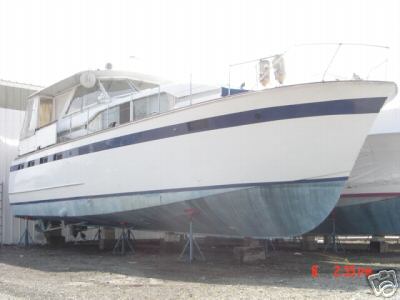

HA! Everybody asks about the stripe... lol
The thing is, I have no idea how this boat's going to lie in the water. I'm going to hold off on the stripe until the boat's pretty much done.

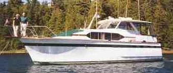

Post Stripes we've seen
All lined up and ready to go (painting).
Fact of the matter is, you want to:
(1) Gradually get wider towards the bow - so as to;
(2) "Capture" (and hide) the porthole windows, and;
(3) Don't allow the flair of the bow to cause the top line to dip or rise - stay straight.
Well, thatz our story, and we're sticking to it.

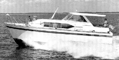

It's splashed.
Colton's Point Marina is under new management that doesn't understand they bought a workboat/DIY marina in SoMD without much water on the approach. They've become inhospitable for my project, so I splashed it and will take the beast around to the bay. I'll haul it at another yard, rebuild the tent before it gets nasty, and spend the next year getting it painted on the exterior and usable on the inside.
http://s10.photobucket.com/albums/a1...t=5165e000.pbw
And check this out--the boat is so light that the corners of the stern are entirely dry. It's almost got a canoe stern waterline! lol It'll be interesting to see where it sits once it's done and fully loaded.

First time in 15 years, the Roamer is free of its dirt shackles.
Leaving the channel markers at Coltons.
After stopping for a minute to haul the dinghy onboard, we got a'movin'.
And a'movin' she does, too. 10kts and she's on plane. Barely, but I'll take whatever I can get. :lol:
Varoom! Water skiing, anyone?
q240z is offline   Reply With Quote

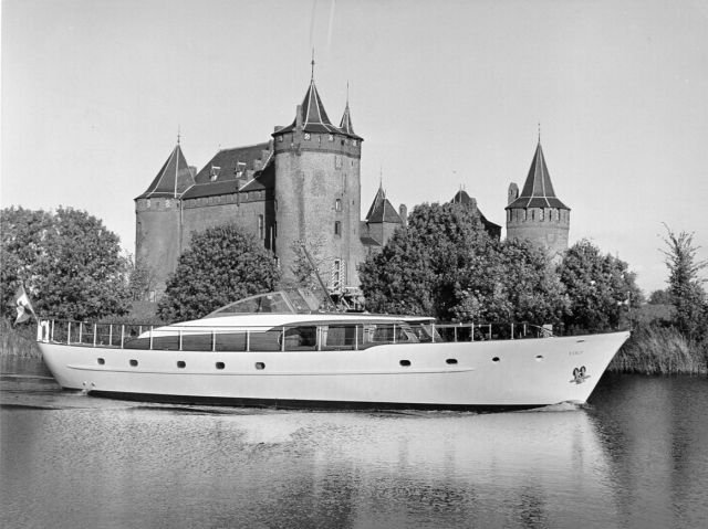

I've been following your posts and thought you might be interested in hearing my story about my 1961 62ft Van lent Feadship ...
I live in London where I work as a music publisher. After many years owning and restoring wooden sailing yachts of various types and sizes (ranging from a 12ft American catboat built in 1900, a 25ft 1930 estuary motor-cruiser, a 1950's BB11, a 34ft 1959 sloop, a 26ft 1938 ChrisCraft and, latterly, Amokura a 51ft yawl built in 1938) I decided that my next project would bea small classic motor-yacht that my family could enjoy and use without a full-time crew .
Eventually, I settled on Alto Volante pka as "Tiky", a 62ft Feadship, built in 1961 by van Lent, and which I found lying in very poor condition in
Pollenca, in north Majorca. Tiky is an interesting boat - she was built with
a typical Northern European displacement hull with a flared bow and a
distinctive cruiser stern, but with a superstructure based on 1950's
planing ChrisCraft design - presumably with a view to selling her to the
USA, which was the reason for the formation of the Feadship federation of
Van Lent and de Vries yards, in the early '50s.

of $80K which, to my surprise was accepted. I thought I had done a very good deal but how little did I know.....
It was obvious that some work would be needed on the 1961 V8 MAN engines and Renk gearboxes but it was only after I had spent over $15,000 on parts that the engineer told me one engine was in a very poor condition and that the Renk box on the other engine was totally seized. The estimate for rebuilding the engines and boxes was at least another $60K. I decided to replace both engines and settled on rebuilt low-revving Gardner 6LXB engines (a snip at $18,000 each!) and which I figured were more in keeping with the age of the boat than more modern designs such as, say, Caterpillars, ...Although the Gardners more or less dropped in place, because of alignment problems, we had to fit massively heavy flexible drives mounted on thrust assembly blocks, bolted to the engine beds - this meant major surgery and new s/s shafts! . While we were about it we stripped out all the engine-room insulation, plumbing and wiring, together with tons of redundant and rusty equipment .
We then started on the hull which had a number of "doublers" - we left some
of them them in situ, replaced others and fitted a couple more, rebuilt the shaft swells and replaced a 6ft section of rusted bow, below the w/l in the way of the
chain locker. We de-rusted , treated and painted the interior, and replaced
all the ER insulation with heavy duty silverfoil faced sound insulation
I was then informed that the new teak deck had been laid on the original
teak deck, (without attending to the rusted structure beneath) and was
separating from the old teak. Accordingly, it all had to be removed. In
fact, the new teak was adhering so badly to the old teak that it came off
easily in sheets. The old teak, which was very badly worn, had brass screws
every thorough every frame, which all had to be removed - a very long and
tedious job - revealing a totally rusted-through steel sub-deck. The deck
structure only had steel plate laid on top of the beams around the outer
edges of the side-decks and on the center line, so once we attended to
the steel, replacing much of it and treating/painting the entire structure,
we then laid 12mm marine ply sheets on to the steel, using a mastic with
only a few fastenings in strategic points, fitted from underneath through
the steel beams into the ply. We then epoxied the ply, which over-lapped
the steel side-plates (forming a "waterway" scupper of about 6" x 3/4" all
around the deck with drains going below the W/L), and a teak edging. We
then applied more mastic on to the ply, then laid 15mm teak with as few
fastenings as possible, covering both the ply and the teak edging so as to
protect the ply edges and hide them from view. We then recaulked the seams
with Sikalfex.
We stripped out literally dozens of old rusted pumps, heaters and aircon
plants, together with miles of old wiring and steel water and heating
piping. We fitted new s/s hatches on the foredeck, completely rebuilt the
18KVA generator, serviced the windlass and fitted new stabilizers and
controls, anchor chain, bowthruster and installed some basic engine-room
wiring and engine-start batteries. We then rebuilt the saloon roof which had
been very lightly built and was sagging at the center. While doing so, so we
fitted a "soft hatch" in the saloon roof so the engines come out of the
ship, without major surgery, should the need ever arise. I was then told that the preparation for the the relatively recent paint job had not been properly done and that sections of fairing had to be removed, so off it all came.
