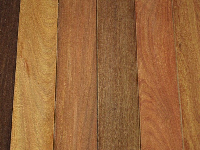

    One word; Ipa. http://www.ipe-wood.com/faq.html#other
    If you have a table saw you can rip down the 3/4 x 5 1/2 inch boards into strips.
    It's heaver than teak and won't hold a stain or varnish very well because it's so hard. I have gone on about this wood before so I'll keep it short.
    It's very cheap, about $1.80 a lin. ft. for a 1x6 .I have worked with it on and off for years now. If you have any questions you can email me.
    Teak doesn't need diamond blades! It's not any worse then any other hardwood. Diamond blades are for concrete.

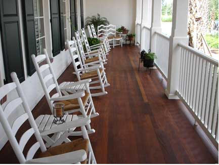

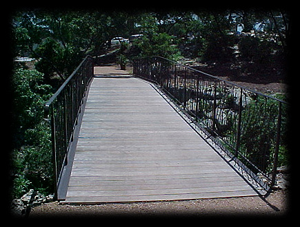

    Couldn't find many good photos there but found some more here:
    http://www.ipedepot.com/deckpicks.htm
    Interestingly, Ipe is a type of Brazilian Walnut. The price comparison with teak is great: $7 vs $15 per unit.:p and kept sealed will retain its original reddish-brown color - not always easy to do: http://ths.gardenweb.com/forums/load/porch/msg1015172230306.html
    http://www.woodweb.com/knowledge_base/Finishing_Ipe_Outdoors.html.
    Otherwise, it will turn silver (see last photo).
    More detailed comparisons here (Ipe/Tabebuia Spp. “Brazilian Walnut” VS.Cumaru/Dipterix Odorata "Brazilian Teak" VS.Teak/Tectona Grandis "True Teak"):

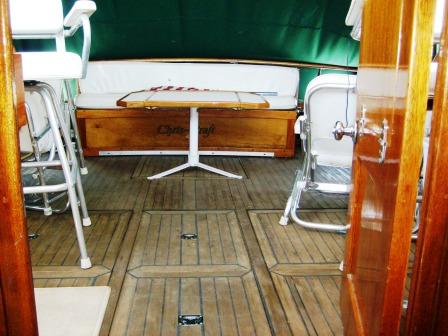

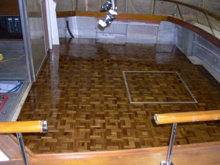

    Finally.
    For anyone who cares - photoEz of what Tek Dek actually looks like outback!:p

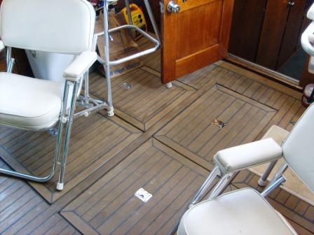

  9. alloyed2sea
    alloyed2sea Moderator
    Jan 28, 2004
    871
    Alex, VA
    Tek Dekky
    Three more for the road. :rolleyes:

    Tin Tonic really does have Tek Dek after all!!
    :D
    Finally some pictures of the finished product!! Looks really nice, more authentic than I would have believed. Looks like the installer knew what he was doing contrary to what the owner said earlier!!
    Thanks for sharing the photos Eric,

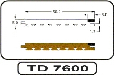

    PS - They even have TEK-DEK "LITE" now (see last photo):
    http://www.tek-dek-international.com/Tek-Dek Overview.htm

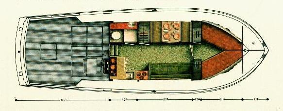

    Thanks Redman. Got samples on the way (you were right - they were more then happy to send me something to look at).
    One more question - Did you send the Tek-Dek folks a schematic of your deck and let them design a package for you, or did you just do the calcualtions yourself (which seems easy enough to someone like me who has never done it) and order what you needed for the job? Thanks again.
  14. alloyed2sea
    Jan 28, 2004
    871
    Alex, VA
    Best part...
    Yes indeedee - sent them a factory blueprint of the floorplan -- and they provided a CAD/CAM schematic of an idealized laydown (including Kingplank) which proved invaluable. Will post this here once I get back to work.
    They really worked to make it happen.:p

    PS - Ten points to anyone who noticed how we "shortened" the engine hatches.
    PSS - And ten more for the reason why.

    Combat PhotoEz
    For the war wary - how we actually "made sausage" -- redoing the back deck with TEK-DEK.
