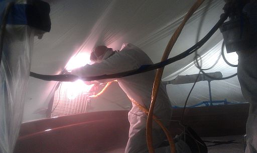

Spraying.. such an ordeal
Maybe not so bad... here is our Rube Goldberg spray booth.. well it worked.. no dust, no nothing... we covered everthing with fresh plastic and provided a fan.
homer1958 is offline   Reply With Quote
Old 08-26-2011, 04:44 PM   #380 (permalink)
Registered User
Join Date: Feb 2009
Location: Annapolis MD
Posts: 460
Spray away men!
This is coat one of 5 in the first shoot. The Chromaclear is so shiny even a micro error in prep magnifies. We must sand it down a bit and shoot again.. with all the sheen it is easy to see the imperfections.. THIS MUST BE "Durablock" FLAT BLOCKED! I ran the DA a bit much, but it is ok.. just have to make a couple of days more work.
Anyway.. that is all for now... hope you liked and picked up some new ideas... remember, this boating thing is not a sport, it's a disease for the frustrated Roamer Loving craftsman, treat as a disease. Are you tired of your desk job? In sum, cathartic, or as I say-- male knitting :-). For the most part we need to do our own prep or it would not be affordable.. a great painter can be in and out in a matter of a few hours.

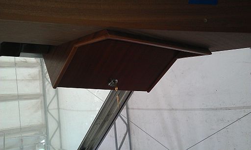

OOPS.. Nav station.. will it save us from Irene? NO!!
Well this one was tricky.. how to build a nice navigation center that does not look like an add-on basement job that you can lock with ease. Well Garmin has the goods.. they got it and man is it easy to use and does it all. I studied RayMarine too.. Garmin 1200 won by a long shot in my books.
Now you see it, then you do not. We built a curved header above to fit it in and it looks great (two dimensional header peice will get header white padding, enough wood ... you can see out and it obstructs nothing much.
