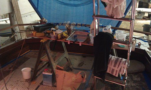

    Wonder why your lifeline post screws won't bite?....
    Wonder why corrosion sneaks out under your toe rail?
    Can we say "Cancer."... Chris Craft did not seal the underside of the wood... To avoid water intrusion and your varnish plugs from popping varnish.. underside of wood must be sealed with epoxy and corrosion must be ground or sandblasted out.

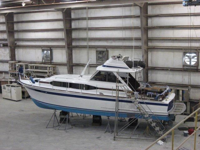

    OK... Let's Cheat...
    At this point.. you are getting depressed thinking your Romaer will never get done... so we flash ahead to keep in mind the final vision at all times (it will keep you going).. so let's miss a few steps for fun and then flash back to reality of sequence.. the movies do it, so we can too :)

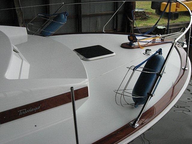

    Nice lines...
    Roamerites and Roamer Wannabees... Look at the classis line of the bow sweep.. that's as nice as it gets... oops, do not forget about the 46 foot Sea Ray which probbly has about the same waterline length as a Roamer 38... Now let's not fudge real size.. Chris is commin back.... No Piper, no Murray.

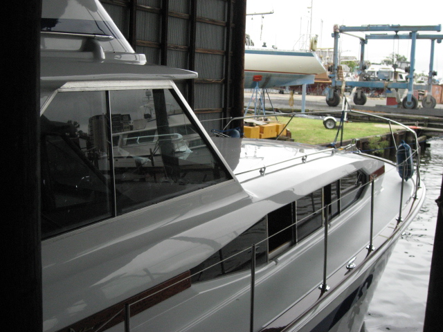

    Gray... ??
    What is going on here? It is Awlgrip 545 epoxy.... part of the proper build process. Once you have blasted and faired.. the next step is epoxy... after that, it's highbuild yellow epoxy .. a thicker epoxy than 545.

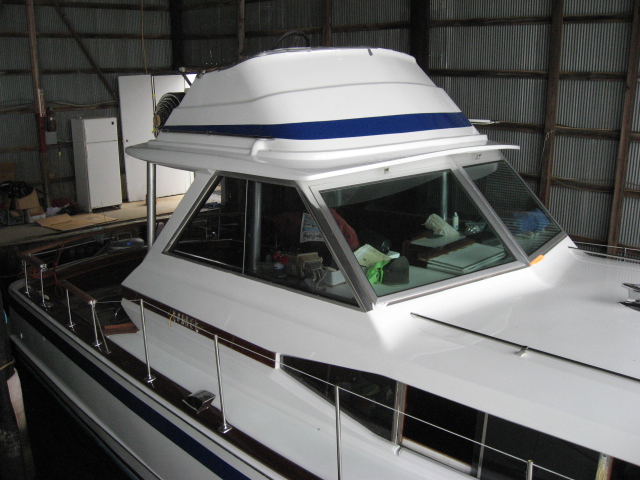

    Time for some white!
    Here we go... Awlgrip Vestal White... it's a nice choice as it is white but has a very subtle hint of blue in it so it merges well with the Royal blue stripes. Striping is tricky... real tricky.. try to avoid the wiggles. Though the factory did not progressively stripe back then, most boats do now and it will give your Roamer a bolder more up to date look. Don't tell me you still have the avacodo shag carpeting in your Roamer.. come on now... the days of polyester double knit leisure suits are not returning. Roamers are great shells to remake if cared for over the years... so please bring her up to date if you can. The exteriors are classic.. time knows no time.
