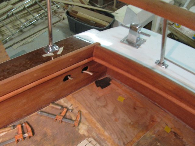

    Wonder why your lifeline post screws won't bite?....
    Wonder why corrosion sneaks out under your toe rail?
    Can we say "Cancer."... Chris Craft did not seal the underside of the wood... To avoid water intrusion and your varnish plugs from popping varnish.. underside of wood must be sealed with epoxy and corrosion must be ground or sandblasted out.
