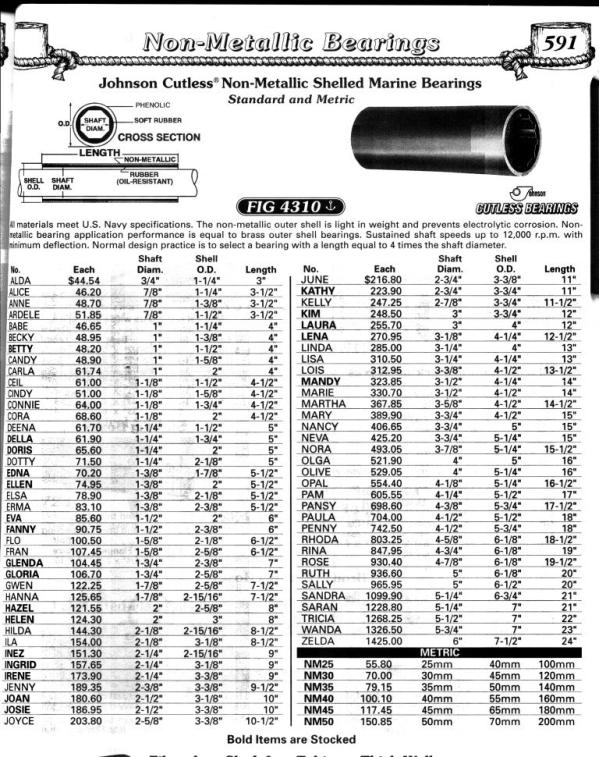

Where can you get new bushing for the prop shaft support strut and how do you get the old bushings out?
It looks like the bushing is metal with a rubber surface where it contacts the prop shaft. The rubber appears to have longitudinal grooves to facilitate water lubrication.
I'm going to weld in new pipes/logs where the shafts go through the hull. The originals are thin in spots. How much clearance should there be? Mine are so rotten, I can't determine the original inside diameter.

Mr. Bio,
If you google cutlass bearings you should find what you want. For example: http://www.deepblueyachtsupply.com/c...sbearings.aspx
...and one way on how to do it...
http://www.diybob.com/diyCutlessBearing.htm
Peter
