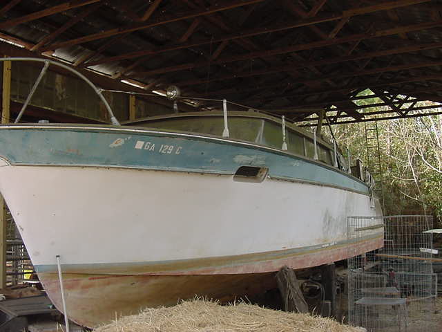

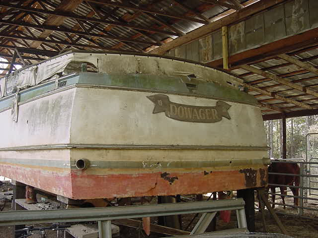

    well, i didn't have it laying around, but i did get 2 10' sticks of it for free.......i'm just hoping the DOT doesn't decide to give me a whole lot of grief........aside from that, i plan on blocking it up at the house in a similar fashon, although, i'd like to have some weight on the keel.....i almost got sick when i saw this boat sitting on just 6 R/R ties with just a few beer kegs under the keel loosely..... BTW...a few pics that i had promised....

    Ok, well managed to get home to South Carolina safe, and ticket-free...by the Grace Of God, the weigh stations were closed....how?...don't ask me!...here are some pics.....

    We had to chainsaw the overgrowth since the boat had been put in the barn years ago.... I took this pic as soon as i got home and out of the truck....BTW...i must have passed 11 state troopers in Ga. and not ONE gave me a second look....i bet if i'd not had the permit, i would have gotten pulled over.....my luck....LOL...now the cleanup of chicken poop (yes there are eggs in the sink in the head), feathers and spiders starts.....BTTW...the Previous owner gave me ALL the orig paperwork for the boat...including the orig order, build sheet, and a photo from (i think) 1958 from a yachting magazine in which the orig owner did a photo shoot...the boat, at that time , was named "Christie II"....really neat stuff....flyers from CC for all the Roamer models.......
