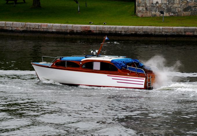

    If you mean that soot is entering from the outside exhausts, it usually comes if you have a backdoor open, creating an underpressure when underway. With a forward hatch or door open as well, this will go away. If your soot is coming from the engine room, you have a problem.
    I just saw this "backsmoke" on a vintage boat passing here on this cold Saturday:

    If it's inside the salon you're breathing it. NG. How's your transom. If dirty close salon door. You may just have a smoker. If it's clean you probably have an exhaust leak. Check first by the turbos and the manifolds. Stay out of cabin while running until source is found.
    As pointed out by AMG remember that all boats suffer the "station wagon effect". You must keep ventilation running fore to aft (close salon door while running or exhaust will be sucked in).
