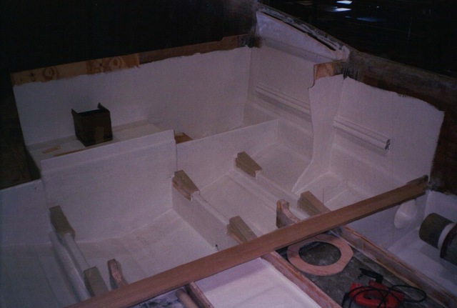

I will ask my dad and also call our former plant manager Stan for you. Between those two I will try and get a definitive answer. I attached a picture of hull number 1, the box you see centerline should be on top of the water tank. Don't quote me on this as I was a youngster and don't remember the exact position but I believe that was where the water tank was.

Thank you for the pic. The forward fuel tank is accessed by the teak and holly cabin access plate square in the middle of the salon. If the water tank is forward of the engine room, then it should be aft of the forward fuel tank. The salon hatch aft of the fuel tank access is for engine room access. I will check again for an access hatch in there.
If the box in the picture is marking the top of the tank, it would seem much smaller than 100+ gallon capacity, but sometimes that is hard to judge.

Are you SURE you are talking about the same boat here?????? The 35' Cabo had 1- 400 gallon fuel tank underneath the cockpit sole just foward of the lazzarette deck hatch but in the cockpit. I've run about 30 of them over the years this I am positive of.......Cabo didn't get into 2 fuel tanks until the 43' and larger.
The fuel tank you are referring to as the foward fuel tank should be your water tank. If you do not have a fuel transfer pump, which you shouldn't, then you don't have a foward fuel tank. The watertanks on the Cabo are fiberglass, glassed in with the rest of the boat. The waste tank should be a plastic tank. Follow the water fill inside the boat, the tank should be midship, parallel to the water fill.
The box shown in the picture is what the batteries are mounted underneath of, or inside of rather.

Pushing the old brain cells here but I do have pape record of a 1996 Cabo 35 convertible with two fuel tanks for a total capacity of 425 gallons and one water tank of 110 gallon.
I then have a record of a 2001 Cabo 35 Convertible with a single fuel tank of 400 gallons and a single water tank of 100 gallons.
I do have a photograth showing the two battery boxes between the main engines just inboard of the forward engine mounts which would go along with the above photo graphgraph showing hull # 1 being built.
I also have a photo graph showing blue fuel hoses going forward and up into what appears to be a fuel tank above the forward fresh water tank.
I believe the battery charger is forward to starboard with the water pump and the water heater aft of that all to starbaord and accessed by lifting the salon deck hatch inboard of the starboard sofa and forward of the starboard engine hatch which is below the aft starboard seat.
The air conditioning unit(s) and sea water pump are to port and accessed through the deck hatch inboard of the galley.
I think the box you are thinking of C. J. are on the later model 40 & above boats where you have 5 or sometimes six group 27 batteries in a vented box forward on the centerline with a bilge pump below them behind another access hatch.
