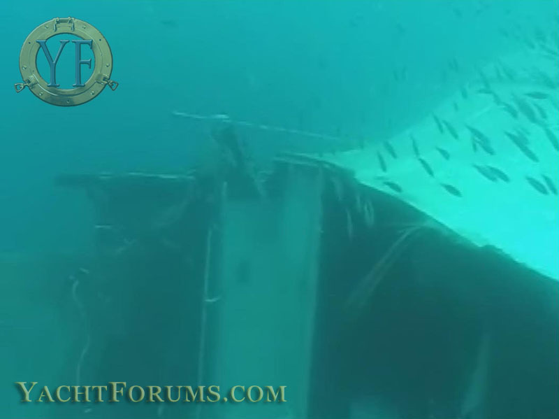

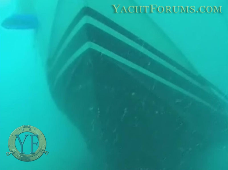

The images have been extracted from a video taken on November 29th, 2009 off the coast of South Carolina. These shots are in sequence as divers made their way down and around the vessel. Captions are provided for narration to better help our readers understand exactly what section of the boat they are viewing.
The first image is taken from down low on the floor bottom, looking up at the forward port quarter of the vessel. The superstructure of the boat is seen in the upper right corner of the image. For reference, we have inset an image of the Bertram 630 in question...

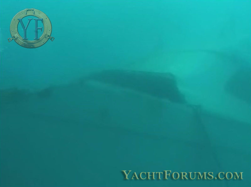

As the divers swam up from the sea floor, they hovered over the top deck of the Bertram, showing where the entire front deck broke off at the upsweep of the superstructure. You can see the port side, deckhouse window in the far right side of this picture.

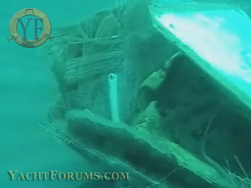

Zooming in on this section, this was the anchor locker. The PVC pipe sticking up was part of the chain guide...

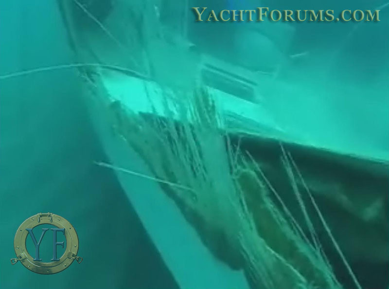

Positioned directly in front of the bow, looking aft along the starboard side of the vessel, this is what remains of the hull, again sheered about halfway between the rubrail and the boot stripe, all the way back to the beginning of the superstructure.

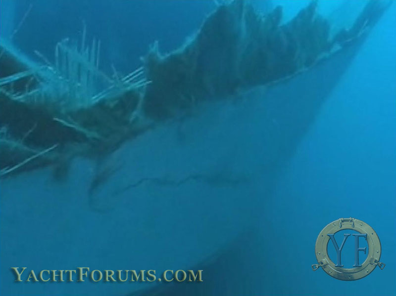

Dropping down from the position above, this is the port bow section. Study this picture closely. The cracks in the upper right corner of this image are located about halfway between the boot stripe and rubrail. They are a few feet long, but they are not completed separated. These are likely to be stress fractures from the hull folding inward if the deck came off when plunging into a wave.

This next shot is a close up of the beak of the bow and what appears to be a large impact area and stress fracture. If the boat hit a buoy, this was likely the point of impact, however it is extremely doubtful the buoy in question (shown in the image below) would have been capable of inflicting this kind of damage.

Here's another angle on the bow, this time the camera is on the starboard side. Notice how the sheering is similar to the port side of the hull, indicating the port side may not have been subject to an impact by a hard object, but rather when the deck came off, it sheered in this pattern...

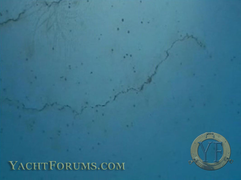

This close-up shows, what appears to be, scratches possibly created by an impact with something, however the hull was not breached here. It has lost structural integrity, but the skin is still intact...
