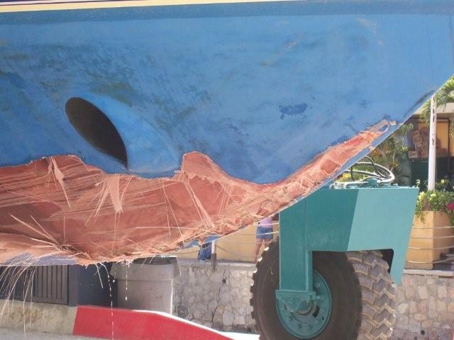

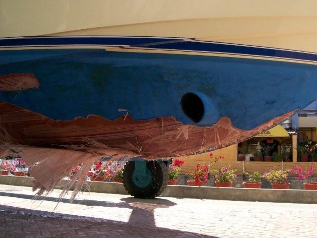

for the record
Every production boat builder, likely any builder for that matter, has had an incident or two that they would like to forget and erase from the public mind. What that builder does with the facts they discover, or others discover for them, will either solidify, maybe even grow their market strength, or spin a dark vortex of self destruction.
We all apparently know what we see in the images, and seem to fully understand the consequences of denial. But in these horrific times for the entire boating industry, we can simply hope the right thing is done, and a founding member icon of the boating world is restored.

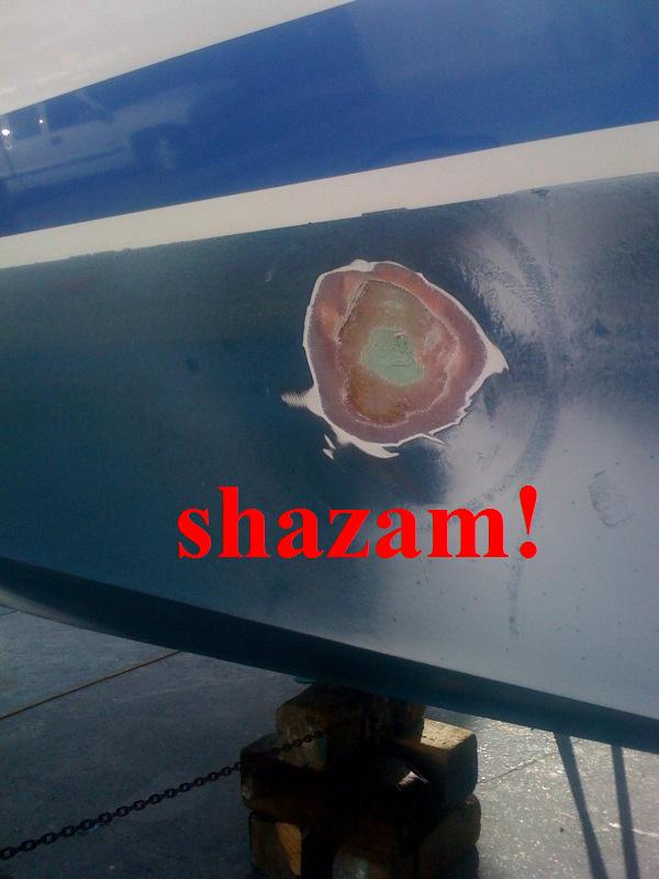

Once again, disregard what I do for a living, assume I have no credibility whatsoever. Let's begin with this fairly innocuous void that was found in the laminate of this near new 450 Bertram...

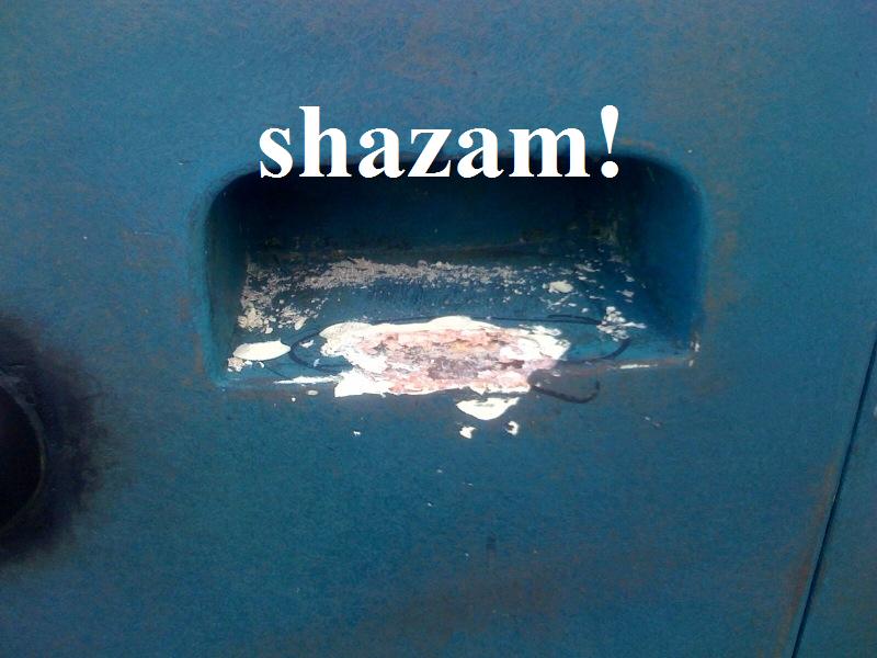

What's the big deal you say? What we're looking at is the molded in step at the stern of the vessel on the stbd side just below the transom door. After all, anyone whose done any lamination can tell you that a part like this may be difficult to laminate and that there may be a bubble or two in the laminate if its not rolled out properly. What this little void did though was trigger the owner of the vessel to hire a surveyor who sounded out the hull which revealed over 90 other voids in the hull below the water line. That's bad news.
But here is a perfect example of the people laminating the parts for Bertram not knowing what the hell they're doing...
SHAZAM is offline

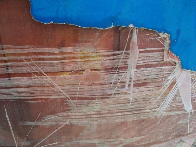

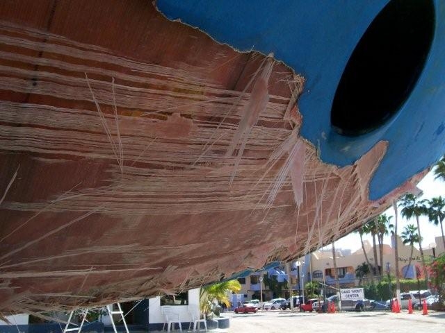

For the astute among you, do you recognize the core material? We've seen it before on this forum. Does anyone remember me saying something about the core used here "outgassing"? That's precisely what's happened here, after lamination the core continued to cure and "outgass" causing the voids throughout the hull to develop. Worse still the core should NEVER HAVE BEEN INSTALLED BELOW THE WATERLINE! IMO the proper core installation in a pleasure boat hull should start 6" above the waterline, the overlap of the laminate in the chine area from the hull sides and the bottom more than compensates for the lack of core from the chine to where the core SHOULD start above the waterline.
Again, forget my credibility or what I may or may not do for a living, look at the photos and use common sense to decipher what's in the photos. Digest what I've posted and if you guys are still interested, tomorrow we'll look at a NEW 570 sitting on the production line.
