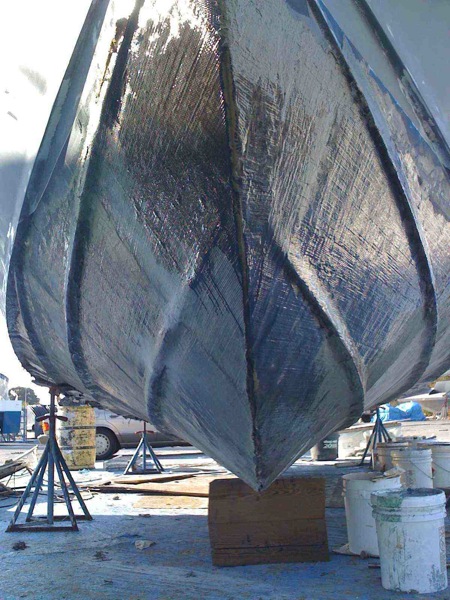

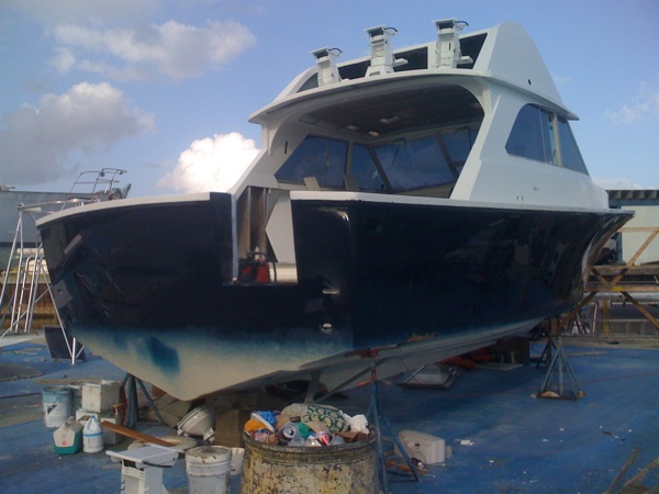

  2. 35bert
    35bert New Member
    May 27, 2009
    86

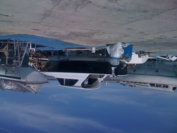

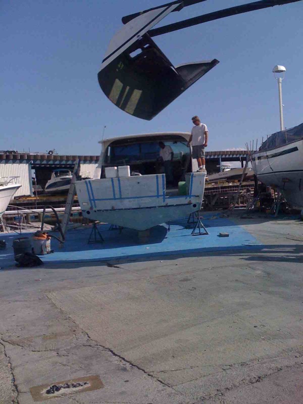

    daina
    here we go

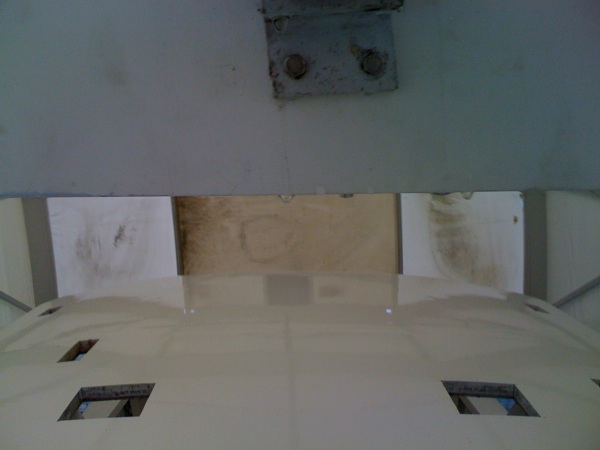

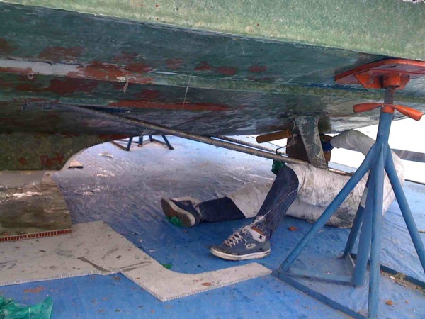

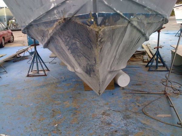

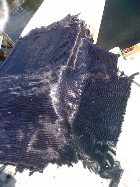

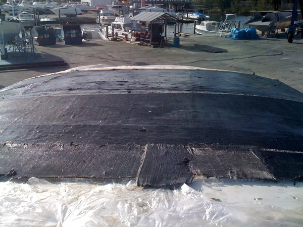

  3. 35bert
    35bert New Member
    May 27, 2009
    86

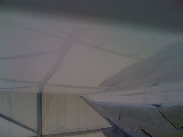

    daina
    on to carbon
    more sticky days

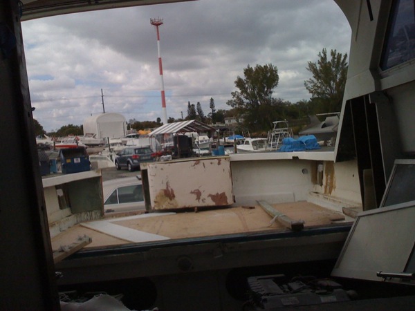

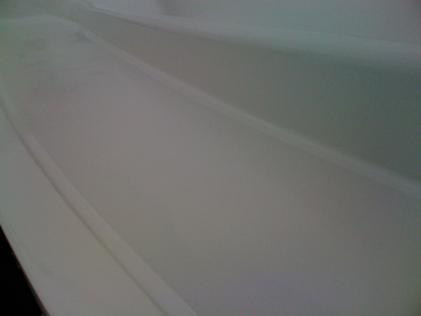

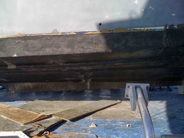

  4. 35bert
    35bert New Member
    May 27, 2009
    86
    daina
    grind sand test fit
    it's so much fun think I build a cabon hard top
  5. K1W1
    7,452
    Much better size :)
    Did a full peel and repair to a 42ft Sailboat once, I know what was involved in that only too well.

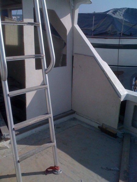

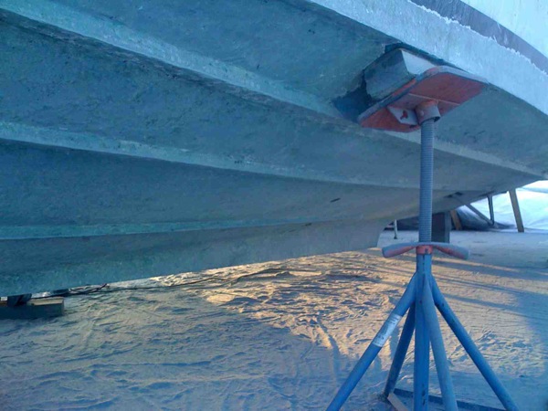

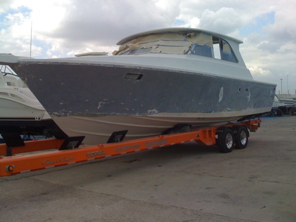

  6. 35bert
    35bert New Member
    May 27, 2009
    86
    daina
    trailerable
    and she's worked my body and it hurts all over.......... test fit and re test fit and prime hibuild then 545....
  7. 35bert
    35bert New Member
    May 27, 2009

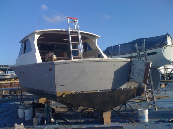

    86
    daina
    the crapyest job in the world
    peeling bottom just sucked I'd rather do any thing, lay up is not any better and faring and blocking is just as bad... just hell under there for two or three months... LOL
    thanks

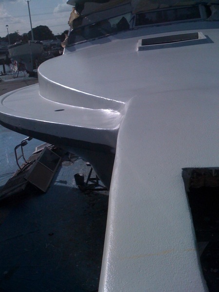

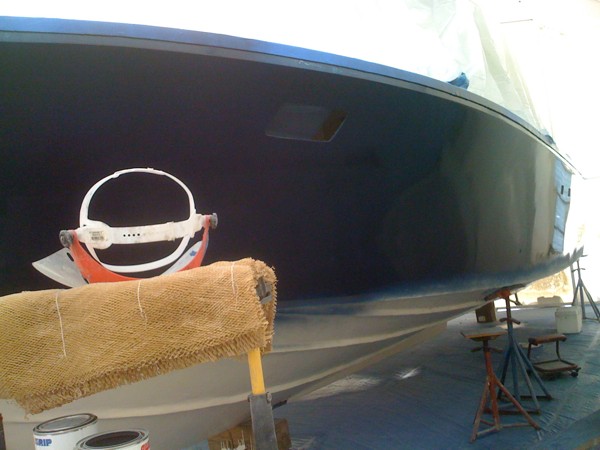

  8. 35bert
    35bert New Member
    May 27, 2009

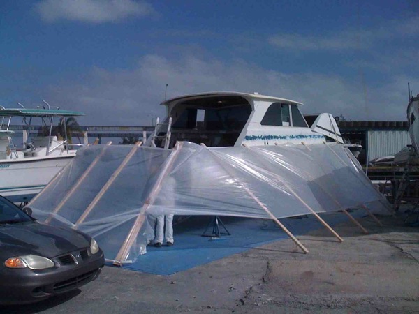

    86
    daina
    just me my sata and a lot of awlgrip
    and they say awlgrip is tricky but thats mostly painters that want 20k to spray me.. good thing I can spray... lol

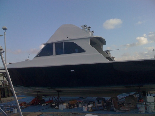

  9. 35bert
    35bert New Member
    May 27, 2009
    86
    daina
    a little clear gos a long way
    and some hard where fitting and almost finished 6 months later that was so ez...... lol

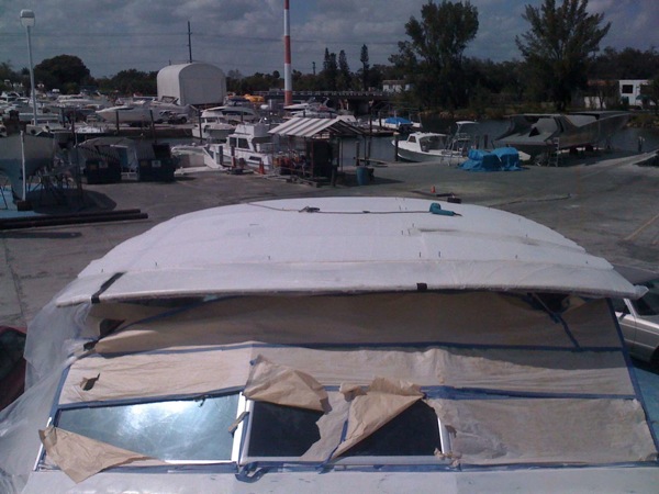

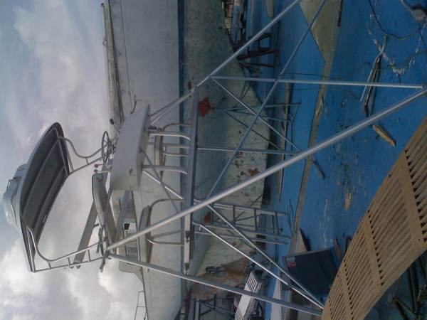

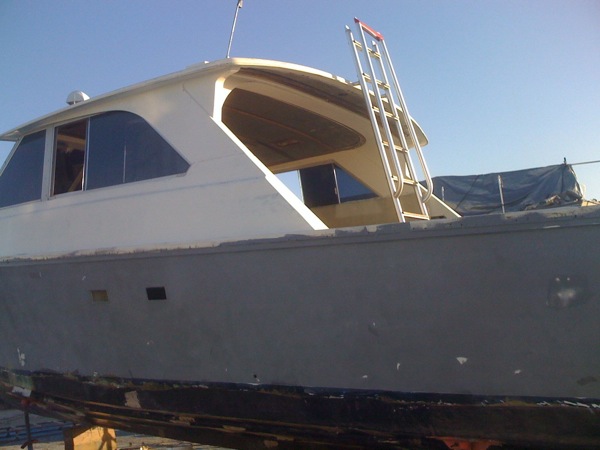

  10. 35bert
    35bert New Member
    May 27, 2009

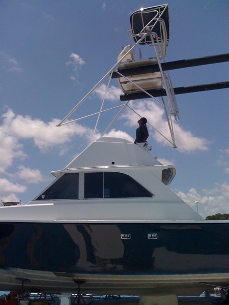

    86
    daina
    and its time to go to work
    so here is the last photo 4 now,, tower test fit
    hope you all git a kick out of the 1973 carbon bottom bertram refit...
