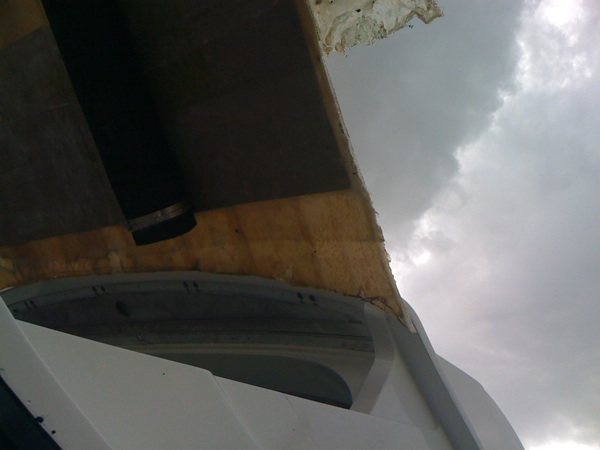

  3. 35bert
    35bert New Member
    May 27, 2009
    86
    daina
    on to carbon
    more sticky days

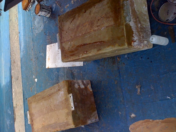

  4. 35bert
    35bert New Member
    May 27, 2009
    86
    daina
    grind sand test fit
    it's so much fun think I build a cabon hard top

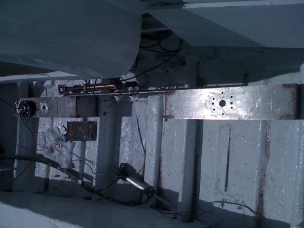

    MORE POWER little space
    so its also about time to run the gen systems. that means fun with amp's... I have been planing to run two d7 diesels with a set of 5000wat gen heads. now the d7 is rated at 6 hp and 4.5kw and seeing as I'd like to keep them belt driven to keep them small I'll need to go with two barring heads. now I have to have a head that I can parallel to 120vac so I can pull around 36 amps witch is the max start load on the ac with the pump running. so now the only two 5000w gen heads that can be paralleled that I have seen out there are the north star 5000w and the blue chines gen heads that are brush heads not brushless like the northstar.. now winco's head can't be paralleled so are there any others???????????? just need a solid 36 amps out of these d7's

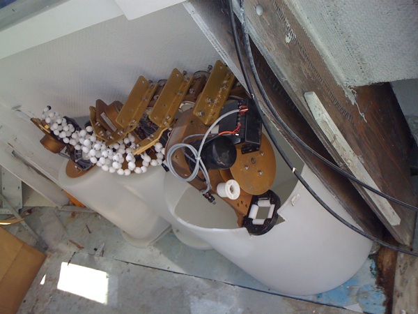

    daina
    lead belly
    well I broke down and went with the 1lb 1in barrier foam insulation with radiant heat foil liner total wight of 120lbs.... I boxed in the whole engine compartment leaving 1 ft openings next to each clam shell vent tube, with a 2 ft baffled on the other side of the vent tube. I installed it by spraying glue on the insulation & what ever we were attaching insulation to also go a thick coat of glue. on the hull sides where there is no wood to screw in too I glassed 2in strips of ply wood and covered it all with glue. then after all insulation was glued in I drilled small holes in the insulation to get thro the rubber lead liner and anchored it all down using 1 1/2in stainless screws and 2" stainless washers... I ran screws every 18in or so and 12in or so on the undersides of the hatches and floor...

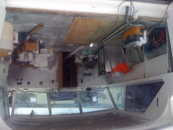

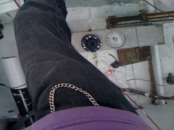

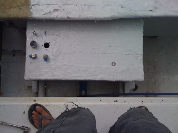

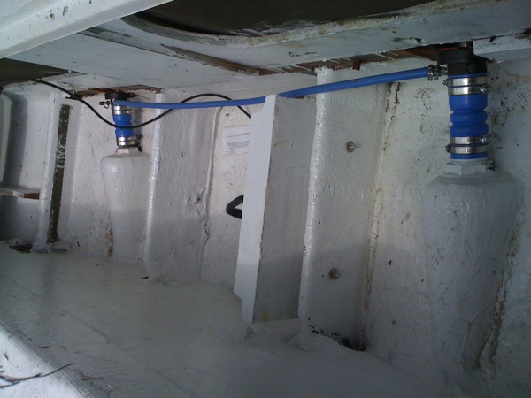

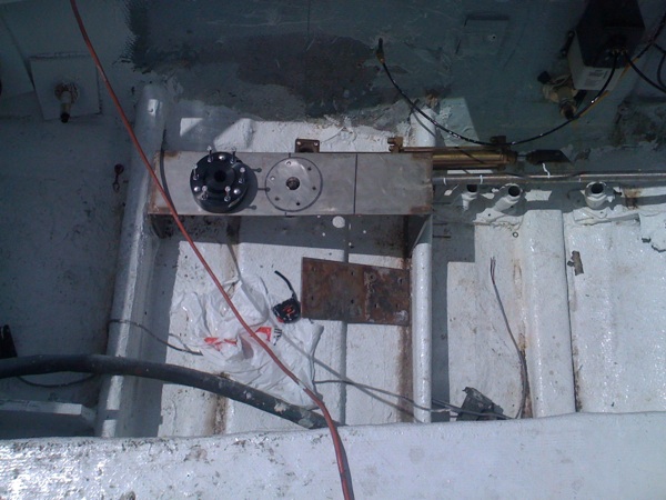

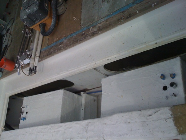

    forward salon bilge
    Well moving on from lining the engine room with the led mat insulation. And on to lining the forward salon bilge. The bilge just in front of the engine room houses the A/C systems, A/C pumps, raw water wash down pump, fresh water system pump, fresh water tank, water heater, water system bilge box and black water system tank. At bertram they put the water tank in between the two center stringers and glass a piece of 3/4 inch ply-wood over the top. For 20 or so years the only prob was a dirty ugly bilge coverd in gray paint, untill the water tank rots out... So I cut a hole in the ply and pulled what was left of the old tank.. I put a water blatter in and installed a hatch in the whole I cut to remove the old tank... When it came to sound proofing I went with a 1 lb barrier glued to 1/8 fiberglass reinforced plastic. It's not as sound proofed a method as the engine room, and causes a lot of interior sound reflection. Now any sound leaving the space will still have to pass thro the barrier & I do not think the same level of deadening is needed to quite pumps & A/C. It also allows for a real clean install of all the systems, lots of witch are mounted on the roof and walls. I'd love to line the engine room with the same stuff but the noise in the engine room will make an inspection of the running motors less then pleasant or require me to put on aircraft runway earmuffs. Or I can cough up the $360 bucks and 90 lbs for the perforated aluminum and that is most likely the safer bet for a cosmetically clean and fully functional sound deadened bilge.... for now I'll just stick with the foil liner in the engine room but the thought is there so you never know......

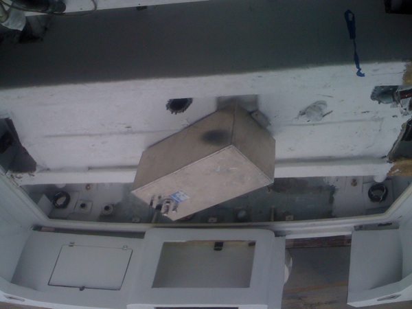

    I want here in the water not in the rain

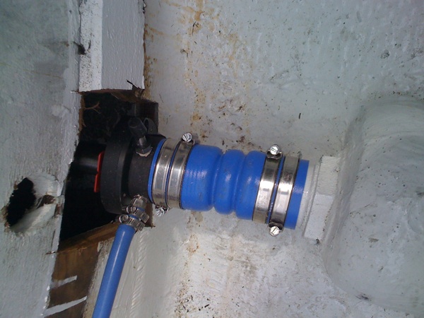

    well this week we are finishing the bilge sound deadening, 5200ing the thro hulls above water line & all the stainless hardwhare. we also pulled all the salon windows and simflexed them back in, 3 days after one window shattered in the night I was laze when installing the last window and over lapped the trim once it was screw down in must have bent the glass and shattered it days later. I am having a new one made now... The rain keeps falling so I do not want to 5200 in the seacocks in fearing that the bilge will fill with water and cover my fresh 5200. worse then that the wiginns lift is down in the yard & keeping me from putting my motors in place, my racors in and the interior in & salon doors in & so on...
    today I think were going to finish the anchor locker and maybe put the bomar hatches in i am also try and plum the bilge pumps, and water system... well see how the weather holds, its raining now

    I switched gears away from the sound deadening and pluming the water system and all the stuff that can be done at the dock but gets done in the rain. So after that bilge was good and dry we got to the thro hulls & seacocks... I had to go with fast 5200 with rain ever looming off in the distance, but the stuff drys quick at 96deg and rain never fell...
    I know star board is the shim of choice for thro hulls but I do not like it I think it is BS and there are much better reasons for using marine ply wood. I have a stack of star board I layed out $60 bucks for the marine ply so cost is not a reason, I think starboard is to heavy it yellows in uv rays and is only good for a cheap cutting boards sold at wall mart...... 1 The fact is that if in a year or thirty years you do leak a little water you will just keep leaking with star board, ply wood dose like wood boat have for the last 4000 years or more and swells then the leak stops... 2 noting bonds to starboard NOTHING not paint, glue, fiberglass, epoxy nothing and that INCLUEDES 5200, that's why you need to rough up the side being glued for it to stick so it can grab the little plastic hairs and bumps... Now I know what your thinking "well starboard will not rot" well the ply wood in my navy run bertram that was a daily driver 37 years had factory plywood thro hulls with no rot.. I have saved samples of what I have taken off the bertram and put on and I know they are factory shims see the same green putty that bertram used to glue in the fuel tank, salon bulk head, engine bunks and so on is all over the shin and needed to be chiseled out. Now what bertram did was slap a bunch of fiberglass filler to the hull the stuck 3/4 marine ply to it then cut there holes and good for 37 years. What I have done was the same alto I used epoxy to make my filler and used mostly resin in the mix to make it rock slid, the epoxy takes a bit to set and the resin soaks into the ply wood bonding the heck out of it. The top and sides are left dry to soak and breath if need be.

  18. K1W1
    7,452
    Hi.
    It is very difficult to apply underwater and gets in your hair and all over your dive gear but it does go off under salt water so don't think it would have any issues under fresh water.

    WOW that is cool to know it will work in such extremes... My friend told me it will dry in water yesterday but that is hard core... I was more worried about the pressure from the water if the bilge filled 12in and sunk the fittings before the 5200 kicked. I tend to over think things and it was only the lowest thro hulls next to the keel that I thought it may happen... Thank goodness it has stayed dry 3 days and maybe to day will make a forth.......
    I will snap some shots to day
  20. Capt J
    14,854
    Why don't you consider using a coring like divynicell instead of plywood as a coring? i agree starboard doesn't have good adhesive properties, but if you're going to coat things with resin and epoxy, divynicell will save you weight and is stronger then plywood.
    Yes, 5200 will cure underwater with no adverse effects. Also, if you keep opened 5200 in the refrigerator, the opened tube will not harden until you let it warm up and go to use it again.
