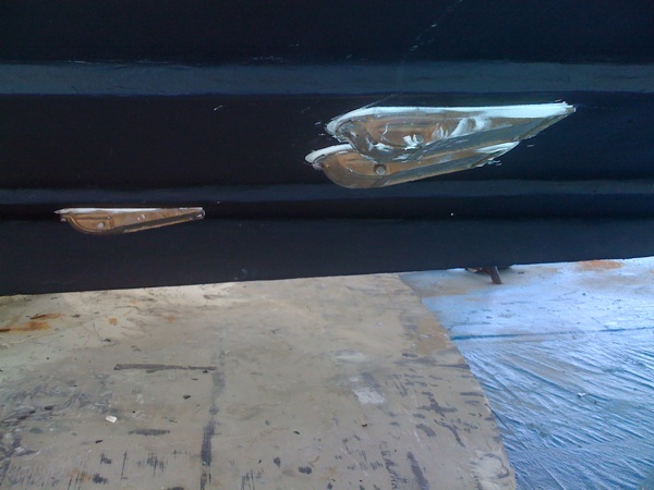

more holes in my boat
well I put on some tabs and stuff like the ocean led lights, and the platform test fit.
35bert is offline   Reply With Quote

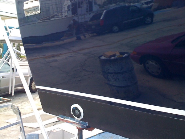

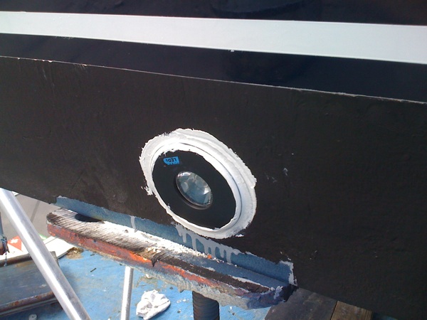

ocean led
all the lights are ocean led, there are two 1520 blue on each end of the transom and one 3010 white in the center there are also two x520 blue on the sides, I have one more 1520 & x520, I am ether going to put the extra 1520 on the bottom in the engine room & the x520 in the transom fish tank seeing as it has a large viewing window in it. or buy one more of each & put two x520 on the sides and the two 1520 between the 1520's and the 3010 two fill the transom more.... still thinking

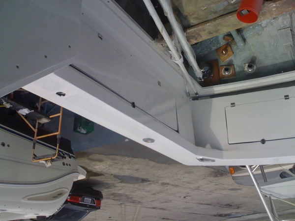

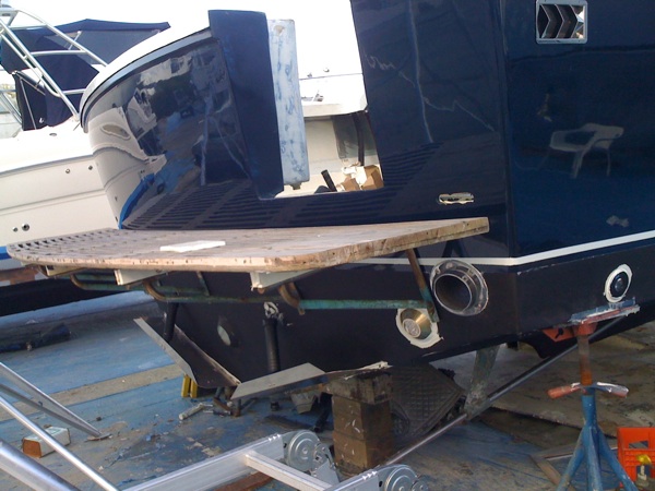

more stuff going on
some of the composit paneling has been installrd in the cock pit, the swim platform has been installed, and the clam shell vents and 50amp cable master....

one more hole in my boat
Well two if you consider there are holes on both sides... As of now I am running fore x520's on the sides, two 1520's on the transom all super blue and one 3010 wight in the middle of the transom. I still have one more ocean led x520 flush mount super blue but do not think I will go to 3 per side, but who knows? I also have an extra 1520 blue, that will ether end up on the bottom in place of the use less drain plug or on the transom. Most likely I will end up buying one more of each and run two 1520's on the bottom and the two x520's on each side of the big wight 3010 on the transom, This will fill out all the water blue around and in back of the boats cockpit and and cause the much power full wight led to peak out past the blue in the back giving a neat effect... If you look in the reflection of the paint you can see I also pulled one engine hatch down and reinforced it with a layer of glass it was flexing a little and the final wood flooring may have fixed it but at $50 a foot for solid mahogany marine flooring I am not risking it...

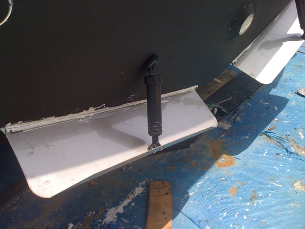

stainless housings, speed & dripples seals
so the stainless steel rudder housings got finished to day an were test fitted punching the whole ate 3 saw blades in each housing but its nice to have a set of solid rudder housings that will not flex or rot with time.. I also get my shafts back tomarrow, and I will give them all my info and have them give me a idea of my top speed with the new diesels. Even with all the extra outfitting on the boat I think the composits will still reduce my weight below the factory weight but will still use the factory weight for my base.
also got the dripples shaft and rudder seals. any one have a big prob with a dripples system?
