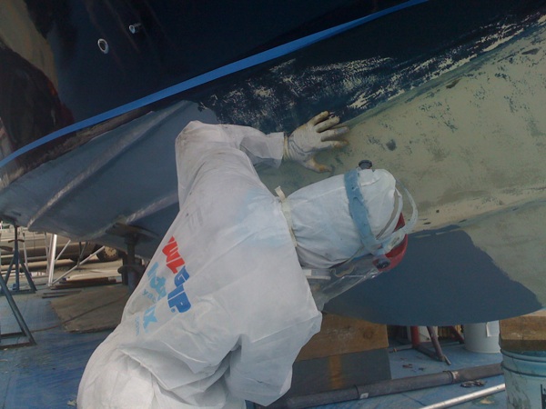

3 full days with no water falling. That is big this time of year in Florida

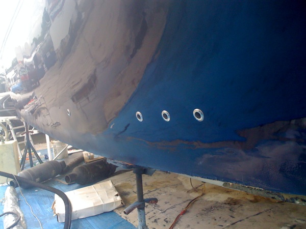

I switched gears away from the sound deadening and pluming the water system and all the stuff that can be done at the dock but gets done in the rain. So after that bilge was good and dry we got to the thro hulls & seacocks... I had to go with fast 5200 with rain ever looming off in the distance, but the stuff drys quick at 96deg and rain never fell...
I know star board is the shim of choice for thro hulls but I do not like it I think it is BS and there are much better reasons for using marine ply wood. I have a stack of star board I layed out $60 bucks for the marine ply so cost is not a reason, I think starboard is to heavy it yellows in uv rays and is only good for a cheap cutting boards sold at wall mart...... 1 The fact is that if in a year or thirty years you do leak a little water you will just keep leaking with star board, ply wood dose like wood boat have for the last 4000 years or more and swells then the leak stops... 2 noting bonds to starboard NOTHING not paint, glue, fiberglass, epoxy nothing and that INCLUEDES 5200, that's why you need to rough up the side being glued for it to stick so it can grab the little plastic hairs and bumps... Now I know what your thinking "well starboard will not rot" well the ply wood in my navy run bertram that was a daily driver 37 years had factory plywood thro hulls with no rot.. I have saved samples of what I have taken off the bertram and put on and I know they are factory shims see the same green putty that bertram used to glue in the fuel tank, salon bulk head, engine bunks and so on is all over the shin and needed to be chiseled out. Now what bertram did was slap a bunch of fiberglass filler to the hull the stuck 3/4 marine ply to it then cut there holes and good for 37 years. What I have done was the same alto I used epoxy to make my filler and used mostly resin in the mix to make it rock slid, the epoxy takes a bit to set and the resin soaks into the ply wood bonding the heck out of it. The top and sides are left dry to soak and breath if need be.
The rain will be back this week so I know I'll be bilge rating it but I am a step closer to the water any way

WOW that is cool to know it will work in such extremes... My friend told me it will dry in water yesterday but that is hard core... I was more worried about the pressure from the water if the bilge filled 12in and sunk the fittings before the 5200 kicked. I tend to over think things and it was only the lowest thro hulls next to the keel that I thought it may happen... Thank goodness it has stayed dry 3 days and maybe to day will make a forth.......
I will snap some shots to day

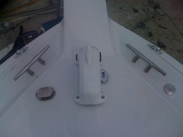

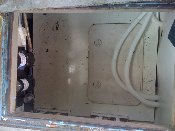

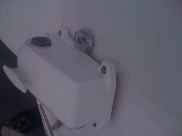

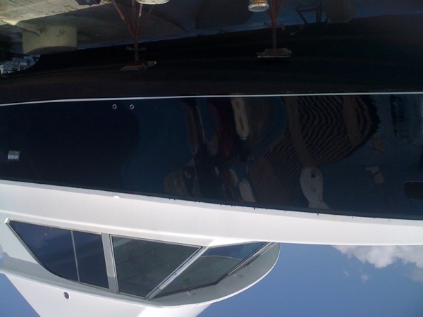

stainless thru hulls and muir windlass
here are some in progress shots
35bert is offline   Reply With Quote

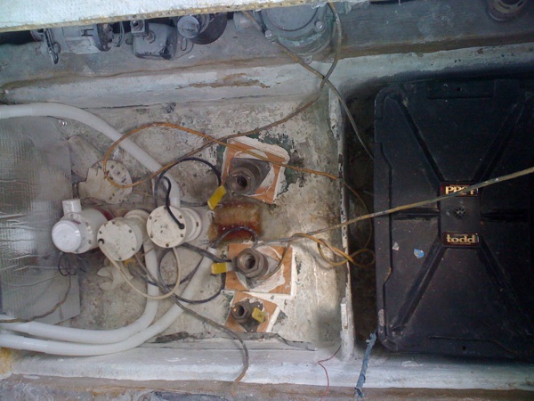

dirty bilge
getting it all in place

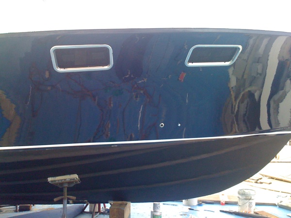

interlux 2000 then the micron 66 & the water line
love the smell....

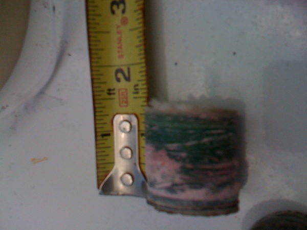

water line and hull cores...
the thickest is next to the keel 1 1/4 the second is by the side on the bottom for the sink drain 1"

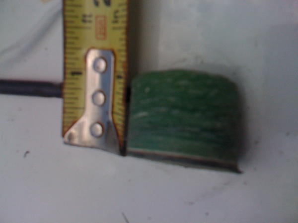

transom bottom core & stainless passage bomars
1 1/2" solid!!!!!!!!! note the 1/16 carbon barrier coat...
