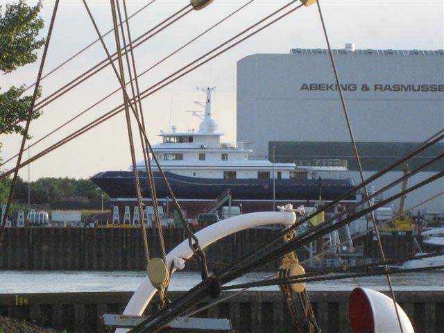

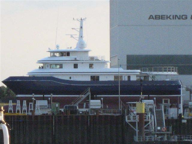

Received these yesterday from a new YF member...

I saw the boat today at the sailfish club (not marina) in Palm Beach FL. The boat looks huge, probably because of its 60 foot beam. All and all the boat look very cool. My only beef is that the hull is very unimpressive. The steel is bent and you can see the seems and welds everywhere. Also, the the boat is painted very poorly making its overall appearance not very impressive. The superstructure is not like this and the "torpedoes" make the boat look very mysterious.
I'd like to see more of these designs but they need a few tweaks.
But thats my thoughts.

Quote:
This yacht was built as a commercial boat in many respects, that is why the superstructure is filled and faired and the hull is not, take a look at commercial ports and the boats in them and tell us how many weld seams and plate deformations you see there.

Quote:
Question, would finishing the hull take structural integrity away or take away the yachts commercial classification. Or do they leave it like that because it is easier, cheaper, and quicker do fix the hull if it gets damaged.
I'm interested to learn about this.

I understand it was done to reduce the delivery time , the overall cost and to make repairs an easier task.
It would have absolutely no bearing on the registration, classification or structural integrity.
