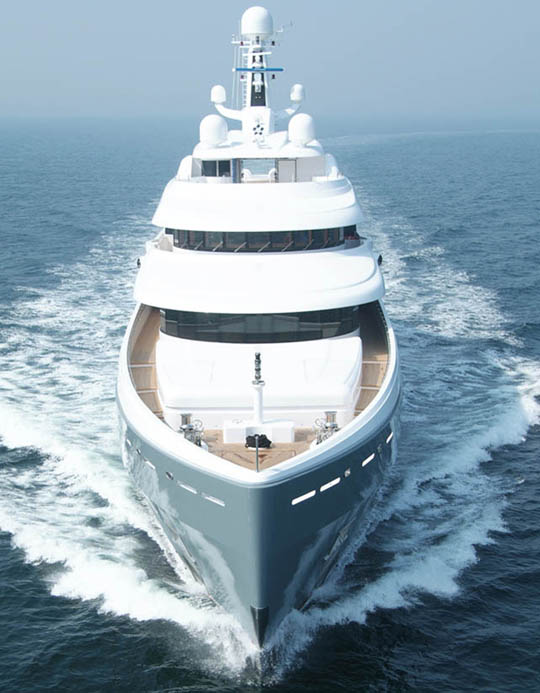

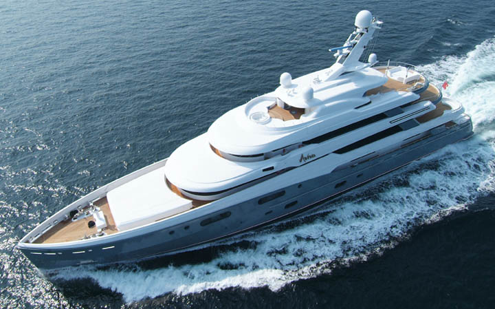

    Far from seeing the requirement for exceptional sea keeping and generous accommodation as conflicting, the client proposed a complimentary solution. By incorporating a very fine, near vertical "knife" bow, the extra 9m of waterline length gained not only greatly increases crew accommodation and storage space; it also requires a similar lengthening of the superstructure for visual balance thus liberating significant extra space throughout. For a further understanding of this design, refer to this link... Aviva Hull Design
    In addition to having unusually spacious guest and VIP cabins, AVIVA has a large observation lounge, conference room, cinema, two dining rooms, gym, massage and beauty salon. A circular glass elevator surrounded by a generous main staircase accesses all six decks and brings daylight down below. Interior and exterior styling has been a very happy collaboration between the client and Reymond Langton Design. Outside opinion has deemed it to be unique, fresh and striking. Abeking & Rasmussen already has a number of clients asking for similar hull form and exterior proposals.

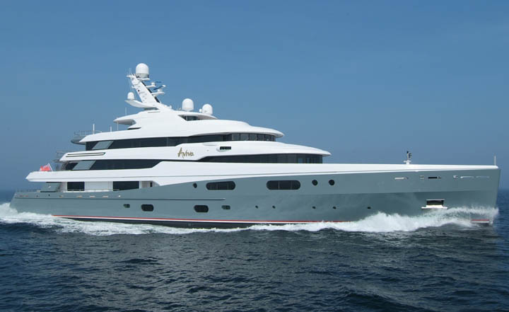

    As for the performance of the "knife" bow, which incidentally should not be added to an existing hull form but requires sections right through to the stern adjusted to work in harmony with it, the results are dramatic. Despite an overall length only 6m more than the original AVIVA the new hull achieves a cruising speed that almost matches the previous maximum and at much lower fuel usage. In head seas, the "knife", bow is a revelation reducing accelerations forward from approx 1g of a normal super yacht down to a mere 0.6g. There were initially concerns that such comfort might come at the expense of "wetness", but this is not the case as the bow has more time to rise due to the longer waterline and extra buoyancy forward. Despite pushing the testing tank until water was coming over its sides, the foredeck of the model remained resolutely dry. Although the hull is unusually fine and tapered aft, a deep, full-length skeg and large rudders placed unusually far aft give the vessel remarkable abilities in a following sea. In tank tests with a 4 metre, 45 degree angle following sea rolls were reduced by two thirds compared to her predecessor thanks to a near total freedom from yaw. In short, the unique hull form has met and exceeded all the clients’ high expectations with no apparent disadvantages.

    Specifications:
    Length: 68 meters
    Draft: 3.2 meters
    Power: Twin 1493 kW Cats
    Speed: 16.5 knots
    Range: 6,000 nm.
    Construction: Steel & Aluminum
    Classification: Lloyds Register of Shipping and MCA.
