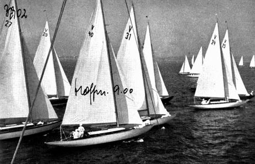

    Hello Spongebob,
    The picture you posted and the dimensions look very much like a Abeking 50sqm Seefahrtkreuzer.
    What are the odds that the previous owner chose the original name when he had to pick one, maybe he still knew it? A&R boats used to have a bronce plate around the rudder shaft telling the year, build number and yard. Maybe the plate was still in place when it was sold.
    For those who don't have a german background: Amsel is german for black bird. Most of the yachts built for the German Air Force had bird names. In 1935 five 50sqm where built for the Luftwaffe, one of them being Amsel.
    In the Register ( http://www.takel-ing.de/pageID_4742970.html ) the whereabouts of Amsel are not known (yet) so I'd say there is a good chance that your boat is the original Amsel.
    Here is the information about Amsel that I have:
    Sail number V 34, built in 1935 by Abeking & Rasmussen in Lemwerder, Bremen. Build Nr. 2930, original scantlings: Loa: 12,45m, Beam: 2,61, Draft: 1,67m. Built without engine, Honduras Mahagony planks on steambent oak frames, first owner: Luftkreiskommando VI in Kiel, stationed at Bug on the island of Rügen. Built to the lines, accomodation and sailplan of build Nr. 2907.
    I attached 2 pictures of Amsel in lightwind racing... or say I'll try.
    Hope this helps,
    Best Regards, Jan
