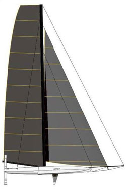

There is one initial sketch on the site (follow the link below). It looks a lot overall from the side like a D35 i.e. LOTS of power (mast height 1.6-1.7x hull length, bow sprit extending to 20% of hull length). IF that thing flies, it's going to fly in force 2 winds easy. Now flying and controlling it in some of the famed brutal and sudden wind shifts / gusts of Lake Geneva, might require pretty solid skills.
Interestingly the "pods" look much smaller in the vertical dimension, as well as longer, so maybe this is one of the future changes for Hydroptere.com - might allow for both faster top speed, and better speeds when not flying (more similar to existing trimarans).
