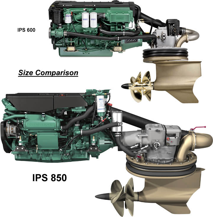

Side-by-Side Comparison - IPS600 to IPS850...

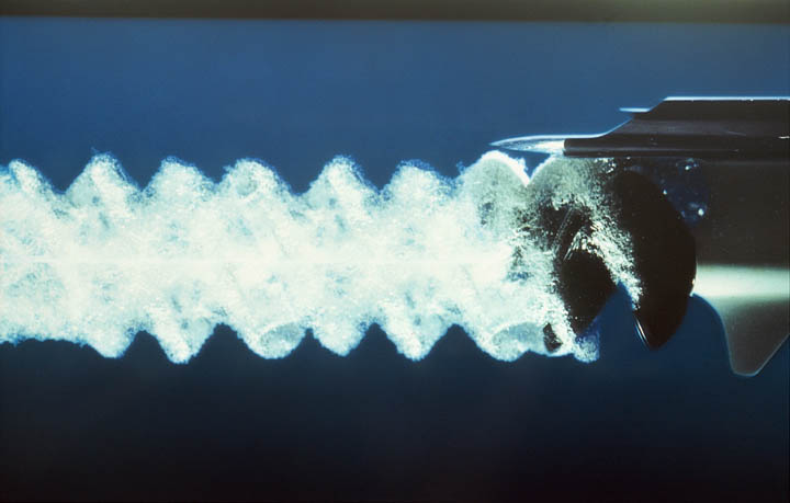

The IPS drive system produces a TRUE zero-degree thrust line, unlike traditional shaft drive systems. This means the angle of thrust is directly parallel to the running surface of the hull. This is FAR more efficient than traditional shaft drives, which are angled down anywhere from 10 to 13 degrees, resulting in lift at the rear of the hull, thus pushing the bow down. This increases the wetted running surface of the hull. In addition, shaft drives also have an increased number of elements protruding beneath the bottom, including the shaft itself, the strut and the rudder. Each one of these appendages contribute to parasitic drag. In contrast, the pod-type drive is only one appendage!
Forward vs. Rear Facing Props…
Because thrust is under considerably higher pressure immediately after expulsion, positioning the props forward of the pod allows for lift to be generated toward the trailing edge of the hull's bottom, resulting in quicker acceleration and lower planing speeds. Another equally important factor is the leverage induced against the hull by the drive system. Remember Newton’s third law here… for every action, there is an equal and opposite reaction. Propellers generate thrust, but they also generate a huge amount of pressure in the form of leverage against the point of attachment. The resulting leverage induces positive trim to the bow. In essence, you have a system that is producing lift for the entire hull. A model of efficiency!

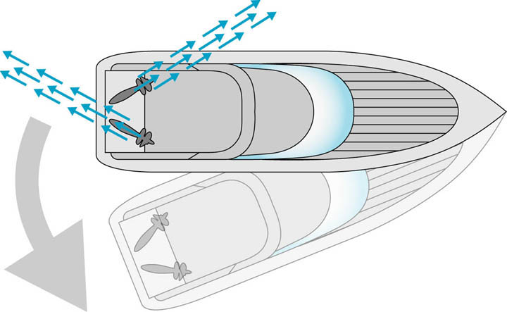

And finally, a new mode of operation has been developed in cooperation with several Carolina-based Sportfish boat builders. When the sportfish mode is activated, the pods rotate to extreme angles, providing unparalleled vectored thrust that instantly swings a transom toward the fastest fish. The rotational force induced into the hull by the IPS pods is multiple times more powerful than traditional shaft and rudder systems. It's an entirely new function and it's attracted considerable attention. To say "Fish Fear This", is an understatement.
Vectored Thrust...

Displacement: 571
Configuration: In-line six marine diesel
Crankshaft output (hp): 575
Turbo charging: Twin-entry turbo and aftercooler
Speed range: 28 to 40 knots top speed
IPS 850...
Displacement: 660
Crankshaft output (hp): 670
