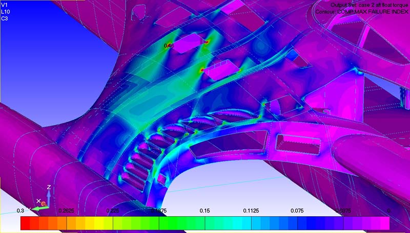

The engineers have undertaken a state of the art structural analysis of all the major components in the yacht in order to achieve the light weight required for very low fuel consumption. All this has resulted in the exceptional vessel that efficiency and luxury. The aft deck has space for a 4.9 metre tender and directly below is a garage which can store a 3.1 metre tender. The garage door has been designed to fold out and create a large dive platform.

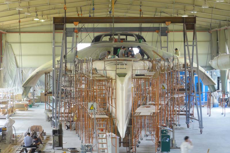

Adastra in build at McConaghy's yard in China. For more than 40 years McConaghy has been at involved in race yacht construction; leading the way in research and application of new materials and technologies to build some of the strongest, lightest – and most successful – racing yachts launched. With manufacturing basis in both Australia and China, McConaghy now deploys its talent and mastery of laminated construction techniques across a number of different divisions, extending the strong commercial platform that has allowed it to defy industry trends and continue to thrive.

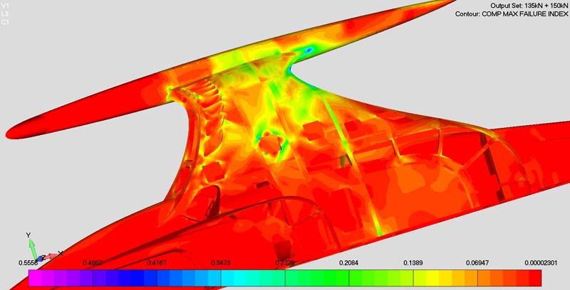

Richard Oliver of applied ASTA has worked closely with John Shuttleworth Yacht Design to assist with the structural design and has carried out a full finite element analysis of the hull and deck structure to ensure that the maximum strength could be achieved within the minimum weight.
